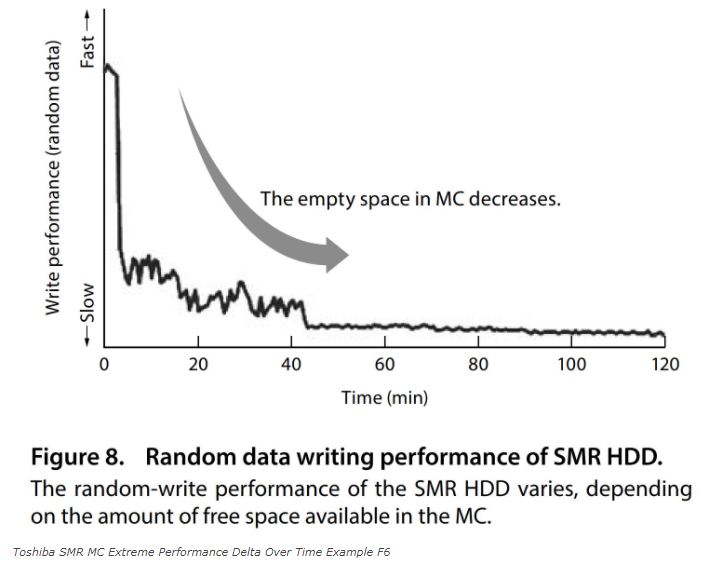

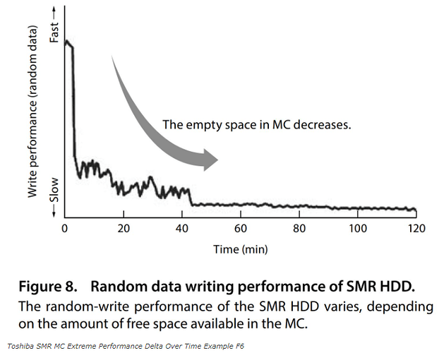

Comparison of SMR hard drive WD40EFAX to SSD (MX500) in a My Cloud Home
Dramatic slow down of performance of SMR recording with sustained random write
