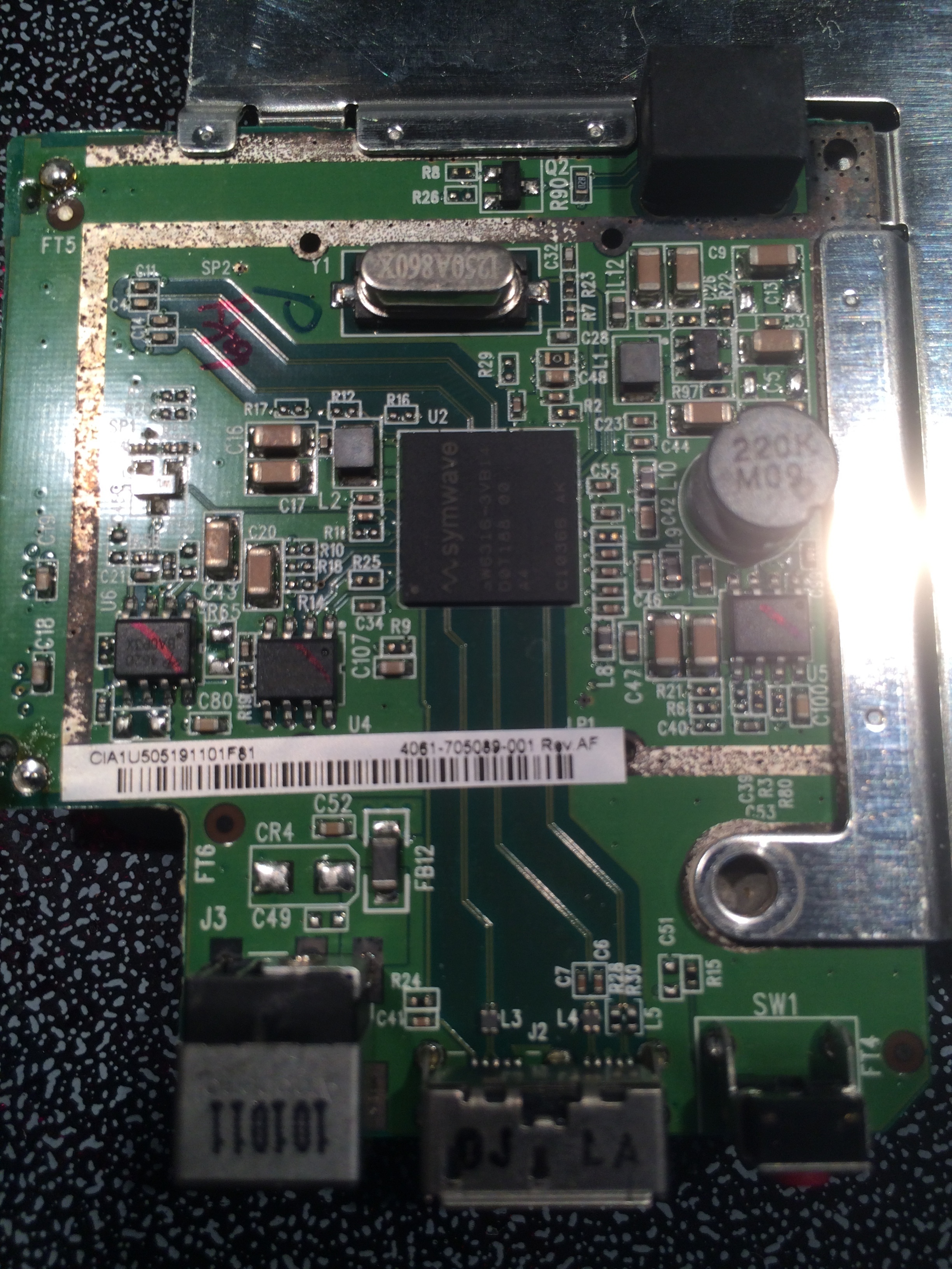

I’m trying to connect the USB to SATA bridge of a WD my book essential to another HDD.
I don’t have any data loss issue, I don’t care of loosing data on that disk and my original WD caviar green 2Tb that was in the enclosure is working great in my computer.
I’m trying to do this because I found a 250Gb WD SATA HDD 3.5" and I have the USB to SATA bridge on a shelf. I though it would be a good idea to create a new external disk and this bridge has the sleep mode option that I like.
Before I opened the enclosure, everything was working perfectly, no USB3 connector issue. I just needed a new 2Tb disk in my computer. I was very gentle opening it and didn’t broke or force anything.
My concern is that when I’m connecting the 250 Gb disk with the bridge, it shows as unallocated space with a write protection on it in win7 disk management.
On a SATA to USB adapter, the 250 Gb disk is working fine, MSDOS partition table and NTFS formatted.

I added the photo of the PCB in case it helps…
Hi, welcome to the community.
Would you share the model number of the My Book Essential? I believe if its one of the drives that comes with SmartWare the SATA to  USB bridge will not work with a drive other than the one that was shipped with.
Hope it helps
wdbacw0020hbk
