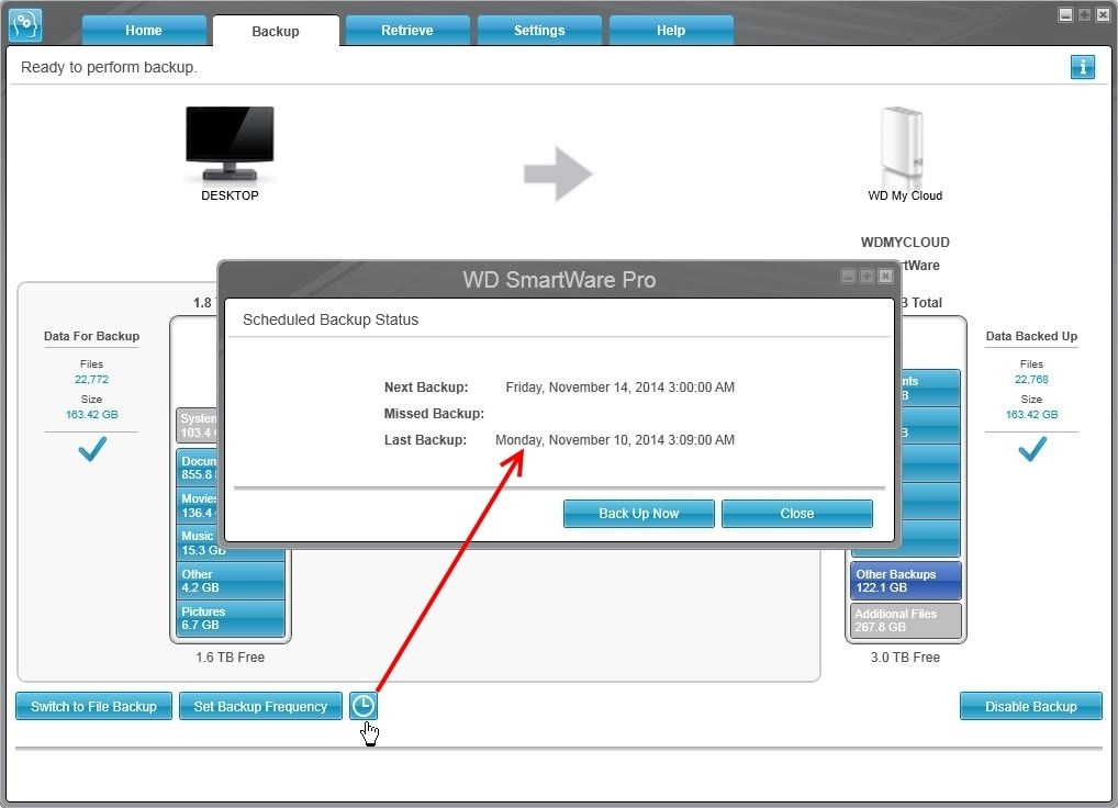

In SmartWare click on the clock and you should see the date the last backup was completed and when the next is due. See image below.
Posted by,
cat0w (USA)

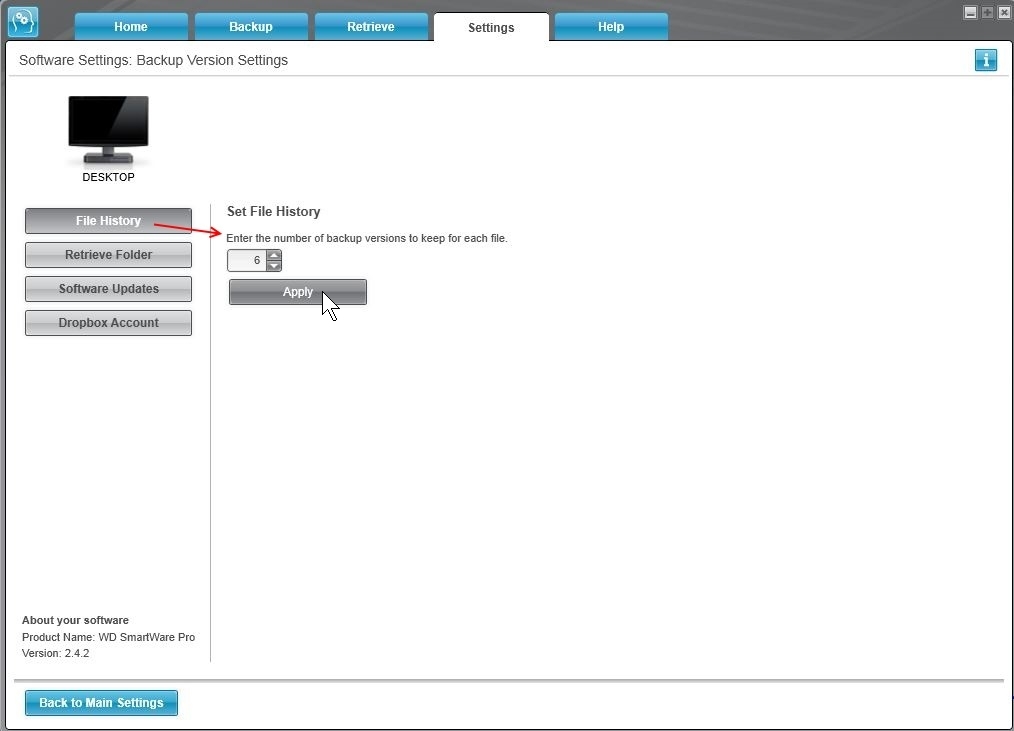

This is for the last question, versions saved. You should be able to set that under the settings tab. See image below. Be sure to click on Apply after making your number settings.
Posted by,
cat0w (USA)
