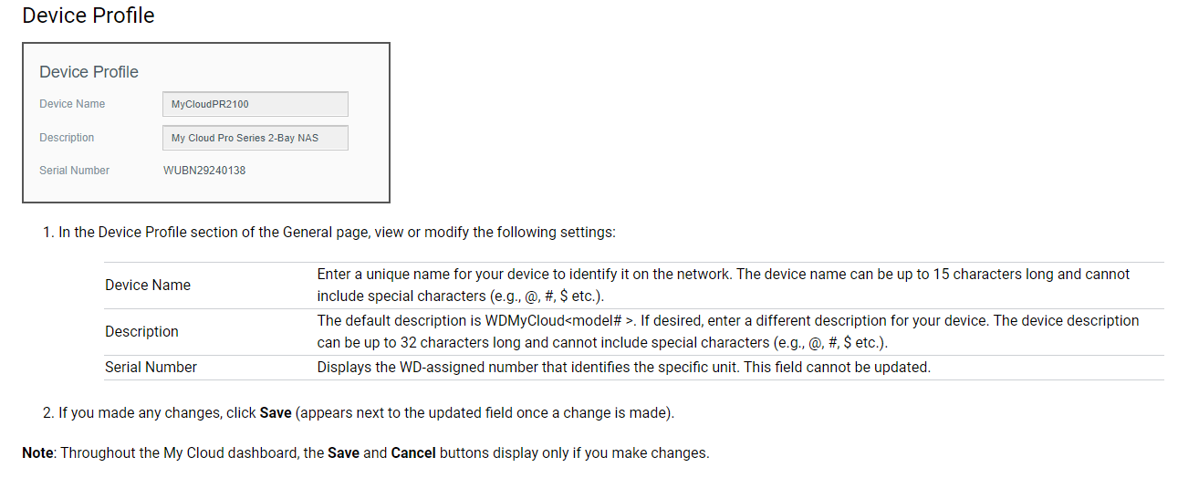

I have several WD MyCloud devices on my NAS Portal so I can administer them all for my client. I recently changed the device name on one from the default name, WDMYCLOUD, to a new name, let’s say, “SampleNAS”.
Everything looks fine on that local network but the name is not being updated on the Portal. How would I do this?

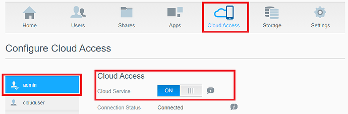

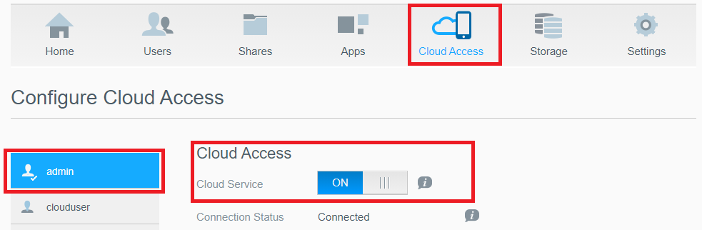

What about turning off Cloud Services, for the user account experiencing the issue, within the My Cloud waiting a few minutes, then turning it back on.
