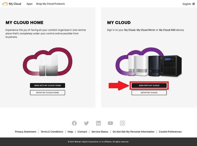

This is an update 6 months after starting this thread.
I don’t access the Ultra EX2 often. When I tried this week I ended up being asked for a Device Code. Don’t have the original paper work, and the device label on the EX2 doesn’t have a Device Code.
Am I using the right web address to remotely access the EX2 (home.mycloud.com)?

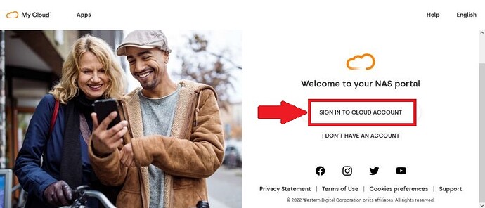

No. Home.mycloud.com is for the My Cloud Home device, which is a completely different device than the My Cloud line of devices. To access the My Cloud web portal for remote access one uses:
https://www.mycloud.com/ (select “Sign into My Cloud” on the right)
Or
https://os5.mycloud.com/
