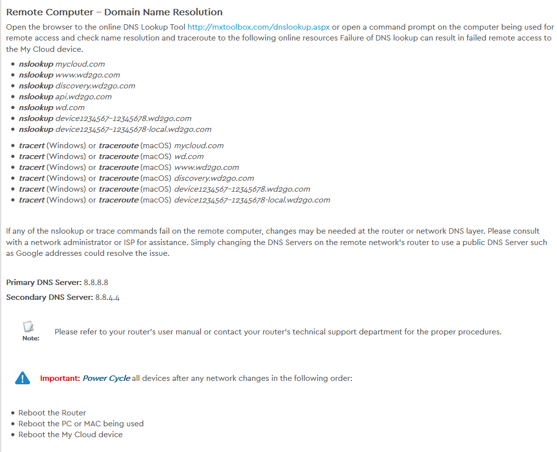

Basically if api.wdc.com and www.wd2go.com cannot resolve, WD Sync will not function correctly.

From the above advice given by WDStaff I tested using nslookup for the various addresses listed.
These nslookups are successful:
And these nslookups failed:
  • wd2go.com (So the www. subdomain works, but the root domain doesn’t).
  • api.wdc.com - non-existent domain. Perhaps this was just a mis-type in the advice above?
I tested these same domains using the DNSLookup tool at mxtoolbox.com and they gave the exact same results.
So my computer’s DNS matches mxtoolbox.com results, which suggest that my DNS is not the problem.
