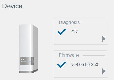

@Guyle First, you own a WDMYCLOUD
WDMyCloudImage and not a My Cloud Home!
My Cloud Personal Storage User Manual (wdc.com)
Latest firmware, see image below. WDMYCLOUD is EOS (End of Service)
