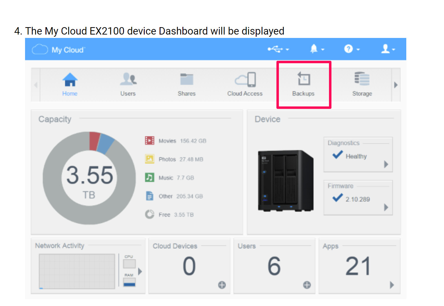

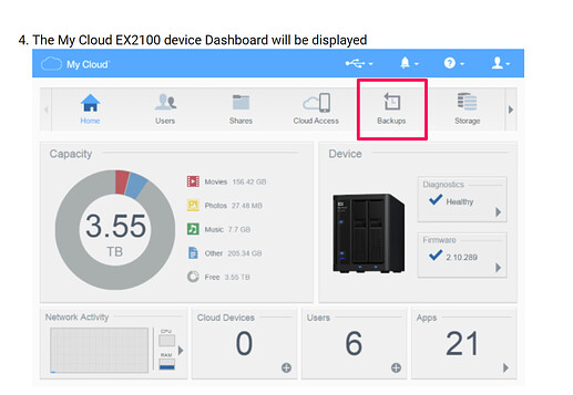

This is what I expect the Admin dashboard to look like

  1. I believe you are running OS5 on your PR2100; and the screenshot of the manual reflects older OS3 software.
  2. There USED to be a backup function built into OS3 WD software. . . now the backup functionality is an “app” - - → called “USB backup” or some such. Once you setup that “job”; the software will backthings up to the USB drive.

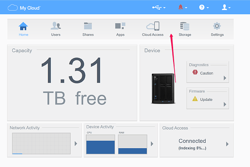

  5. You screen shot shows the PR2100 to be indexing. STOP INDEXING RIGHT NOW.
  • Basically, indexing churns through the drive generating thumbnail previews for the WD Apps.
  • Indexing will wear out your one remaining good drive faster. . .(and may have compromised the failing drive).
  • Indexing can be stopped by turning off cloud access.
