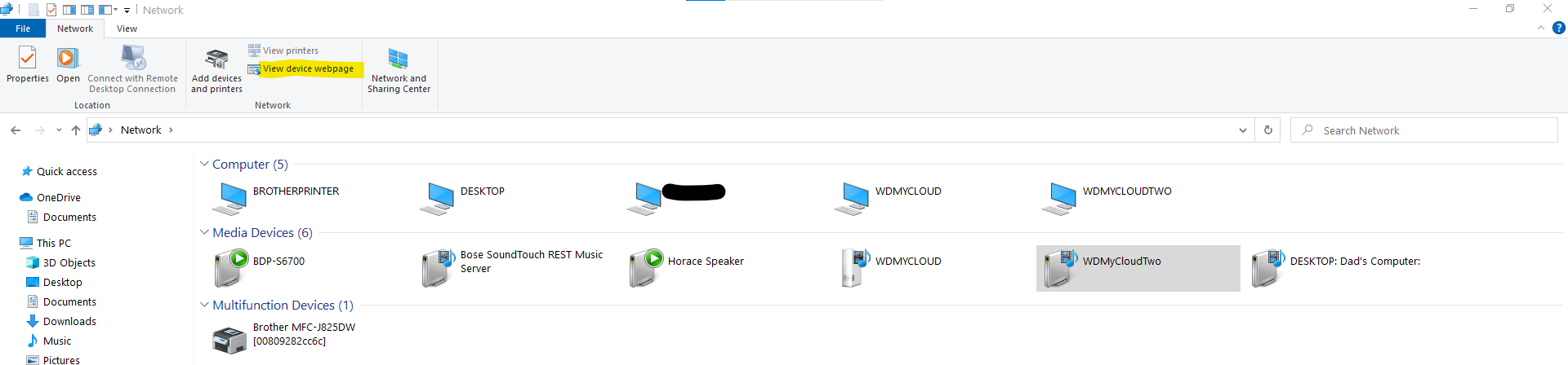

Did you already try this? Click on, tap, or activate image to enlarge it.

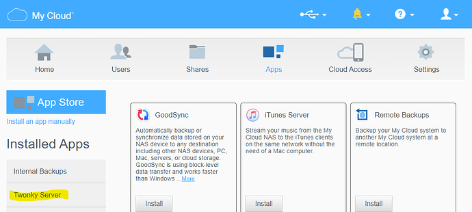

Is Twonky showing in the Dashboard?
No worries. Thanks all for your help.
Twonky is now working in OS5. It is just that there is a long delay for Twonky to startup (at least 40mins) once it’s installed. I can now connect to it to configure as before.
