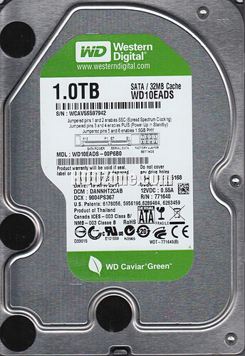

I submitted a pic of HD that clearly shows the model number. If you look at the resources I sent, you might provide a more useful service. You do know you’re in customer service, right? Now I’ve got two of you brainiacs telling me to put the HD in an enclosure. If you learned to read, you would see that I am asking for a port schematic to specify the port on the HD side of the cable. You remember, the one I am trying to purchase to attach the HD to the Mac. Here’s what we know so far: The Mac uses a USB-C. Now, all we need are descriptions of the ports on the HD to specify the other end of the cable. Get it yet? Jeez. Do I have to draw up an algorithm?

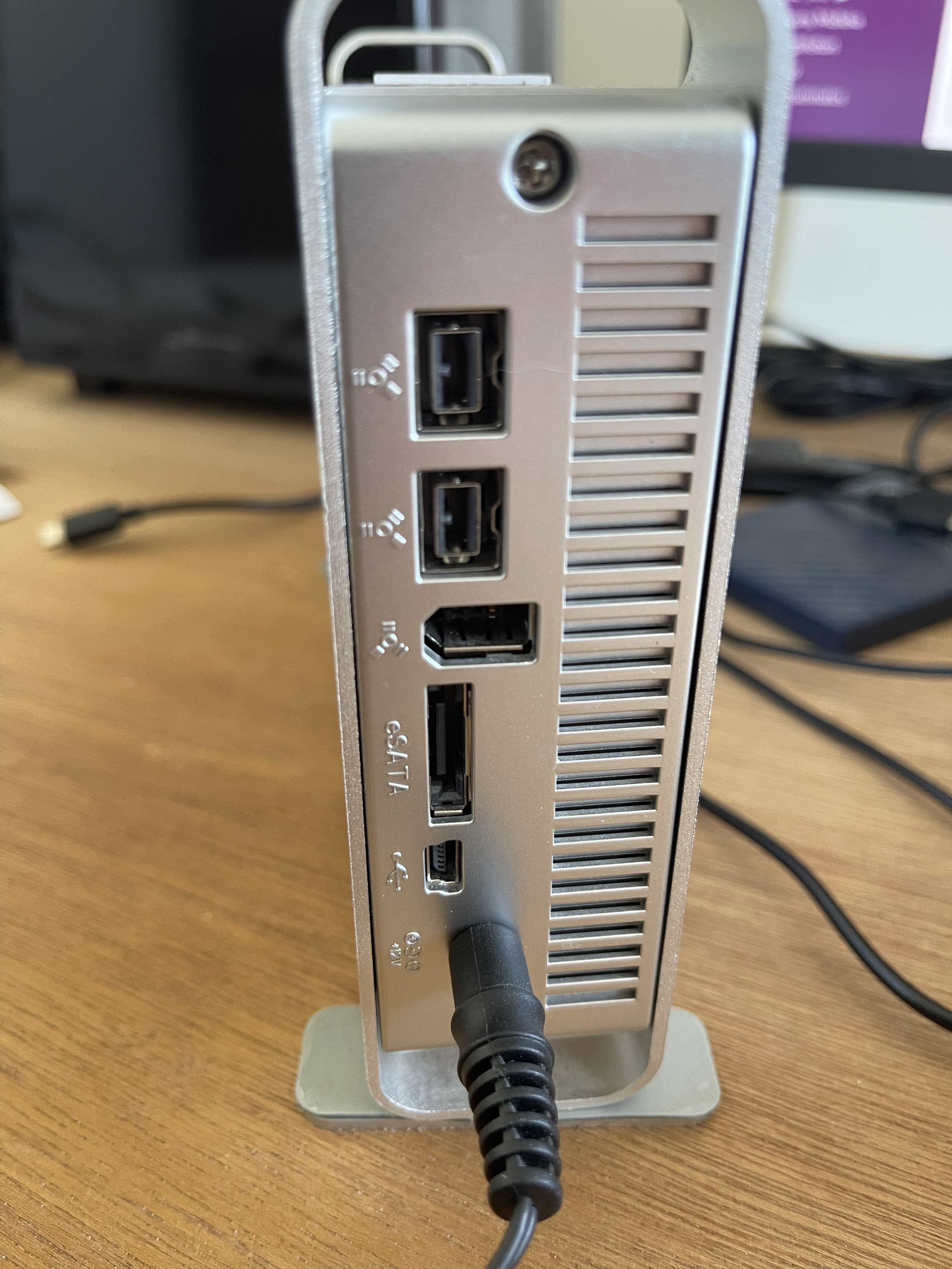

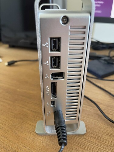

This is your HD. Please label the ports in the attached image:

In this photo I see a mini-USB close to the power which connects to the machine. Then there is a eSATA port and above that are 3 IEEE 1394 ports.
