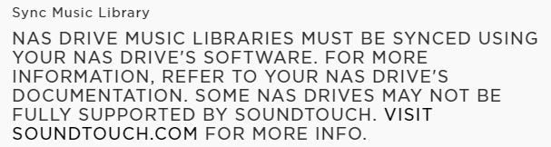

I just checked my app and had to install a new update. To install the update, I had to download the app, remove the old one and then use the downloaded new update to install it. Below is the updated app information.

Here is what shows on mine. I have a WDMYCLOUD, 2nd generation.
Have you tried to resync it?

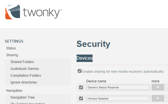

I’ll add this also since I have Twonky. Here is what I have showing on it.
