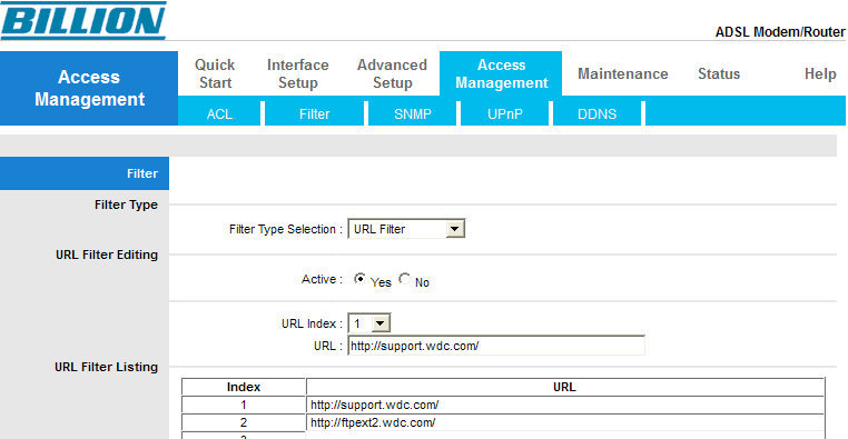

Is there a way to block the WDTV Live from searching for updates? I’m happy with how it’s running on an older firmware, and worry that the kids might choose the l;atest available update that shows up when it turns on now. Perhaps blocking the address it’s calling at the router side - but what’s the address? Anybody?

Block support.wdc.com in your router for the LIVE’s IP.
Thanks, I’ll give that a go.
Thanks, just tried it and it works like a charm :smiley:
That’s great thanks:smiley:
By the way. What’s the http://ftpext2.wdc.com do when its not blocked?
