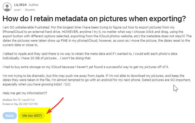

Apple doesn’t let you export metadata from their photo library, it is proprietary data which ensures Apple users will stay with iCloud Photo, an Apple business decision. But there are partial solution:
ExifTool
Just for completeness, though, I did look at the documentation, and with ExifTool , do this:
exiftool -r '-DateTimeOriginal>FileModifyDate' directoryname
