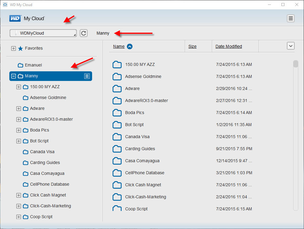

If I open it on the Desktop APP it shows all the files there as normal as one can see here:

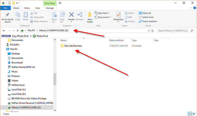

When I go and open the same directory on the mapped drive all the files are not present as you can see here:

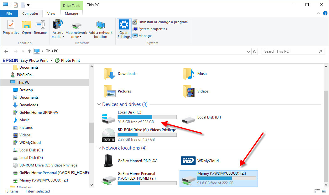

And to make things more weird when you look under this PC the system says that the size of the WD MyCloud is the exact same of the C drive as you can see here:

Here is the other image:
