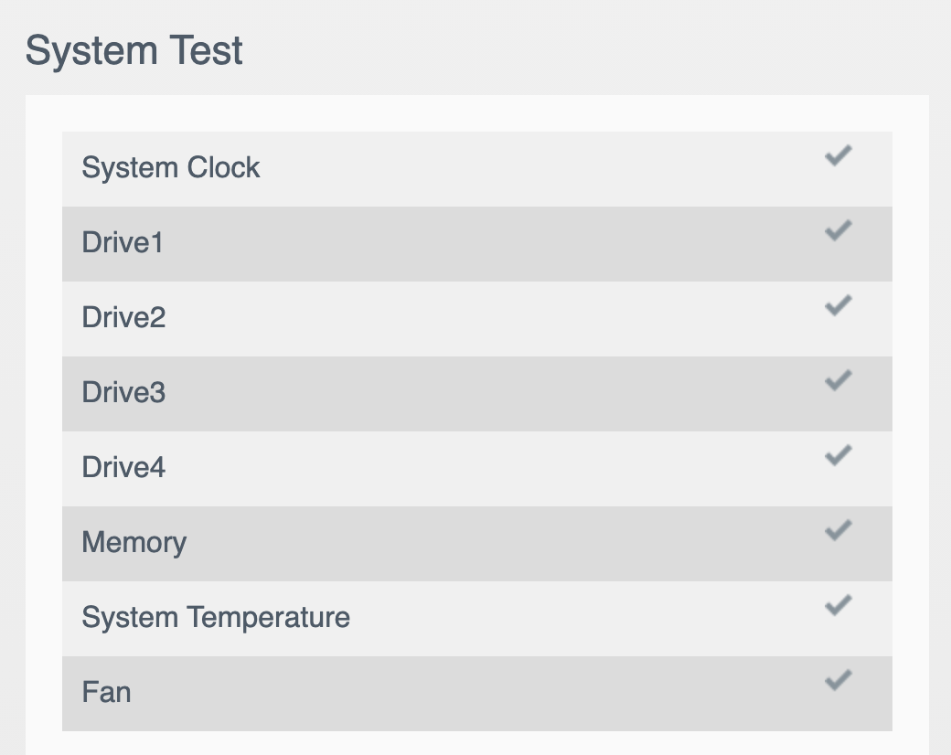

@richardbrockie, Please clear all notifications from your My Cloud device and perform a My Cloud System test
System Test: This test will review the health of the hardware on the device, such as the hard drives, fan, system clock, and device temperature. The test may take a few minutes as it verifies the unit’s memory, temperature, fan, and more.
Check this link: My Cloud: Run a System Diagnostics Test
@Neha_07 - done - everything looks good.
