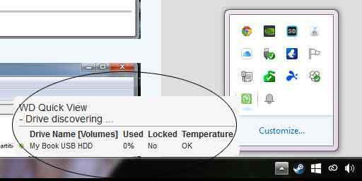

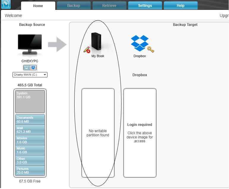

Upon doing so, I was no longer able to access my files. I can see the HDD listed in My Book Smartware.

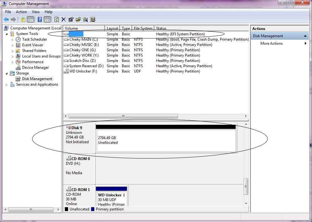

I can also see the HDD listed in computer management along with all my other drives.

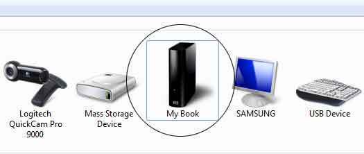

And it’s also listed in my Printers and Devices.
